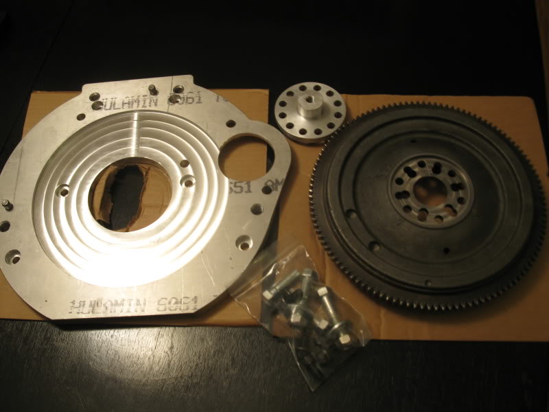

I started by swapping over my Toyota axles, sprung over and I used the 5 speed and Transfer case from the Toyota as well. The adapter is from 4x4labs.com I got one from the first run that Luke made.

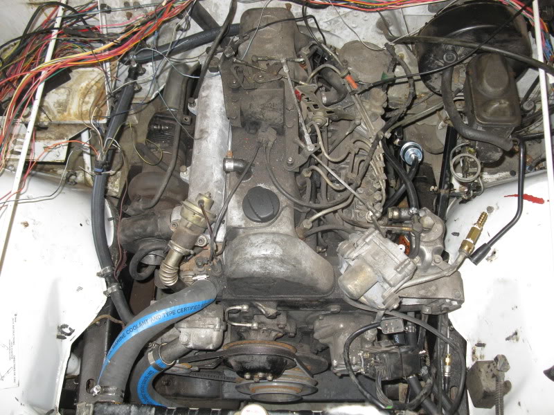

The Engine is in now. But I'm still stuck on a few bits
I still need to figure out the intake, all of the electrical, and the vacuum tubes.

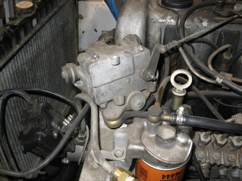

I don't know what this is either? do I need it? can I remove it?

that is the cruise control. I have yet to find the answers for the other ?'s. I am just starting to put my 0m617 into a 92 cherokee. I'm keeping enitre jeep drivetrain(ax-15), and using the adpter kit form Koch enterprises.
