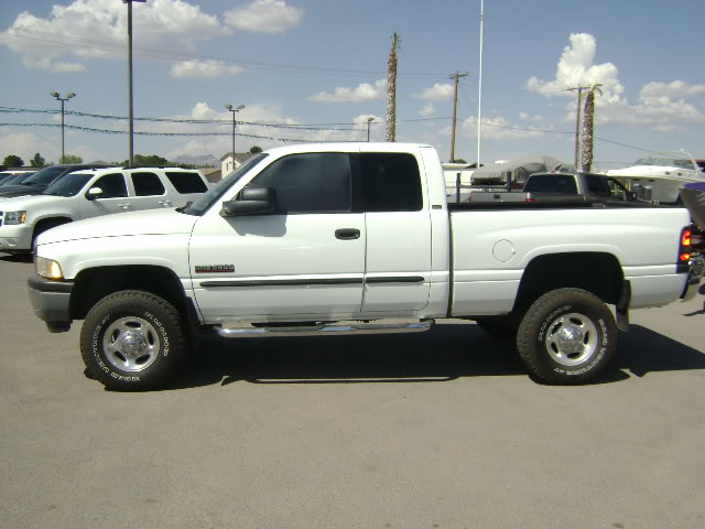

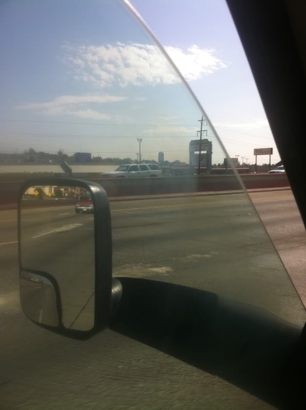

First impression was its just shitty tint, so i removed the old worn out tint and still have the foggy/ hazy look. What it looks like to me is sand got in between the glass and weather strip and scratched the two front windows up. The scratches are very light as you cant feel them with your fingernail or even a razor. When the windows are wet they look good as new. My question is: Is there a way to fix this w/o buying new glass?? Ive looked into polishing but there is so many products out there and some people say not to do it on tempered glass.
Any help will be appreciated!

yeah looks like polishing won;t help you..

We have had "decent" luck with 00 steel wool. It's not great but its as rough as our window tint man is willing to get with a customers glass

my dad had the same problem with his and he asked me to fix it i just got some rubing compound and a MICRO FIBER CLOTH and just polished the window untill it looked new
