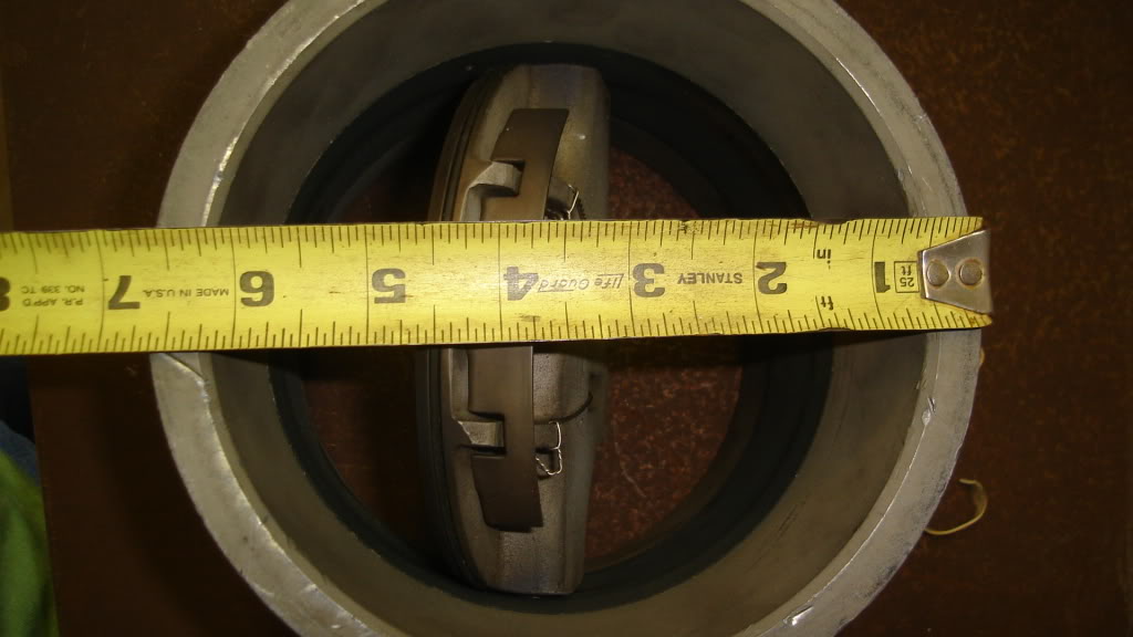

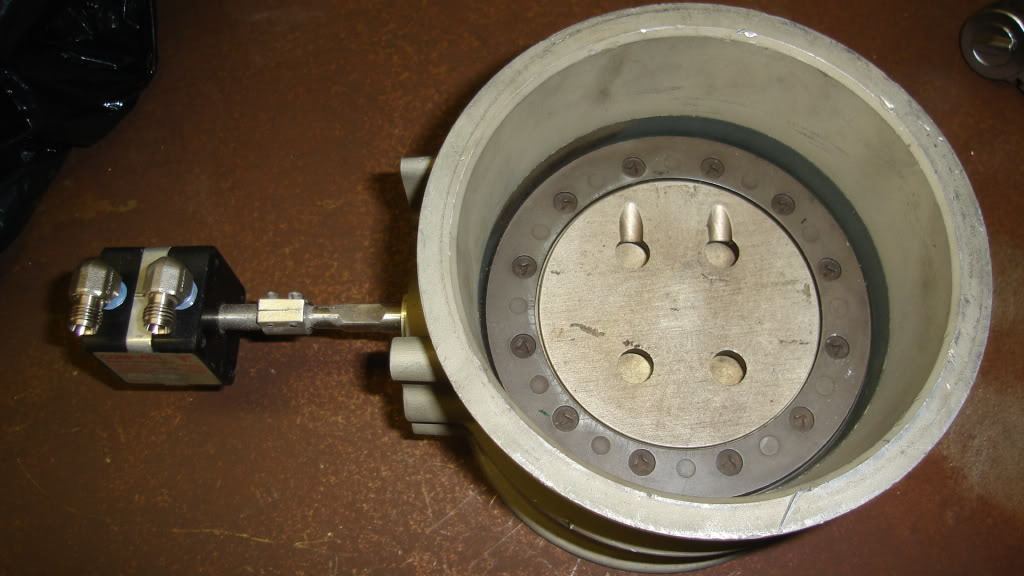

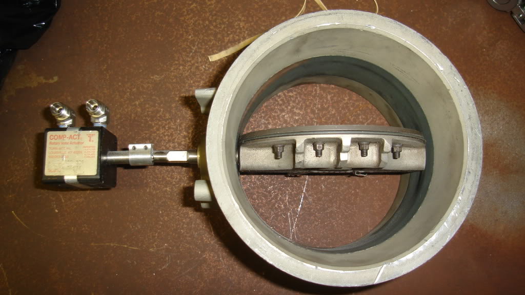

Isolation valve off an L-1011 Lockheed Trijet with a mini pneumatic rotary actuator.
Too bad V-bands for it don't exist.
