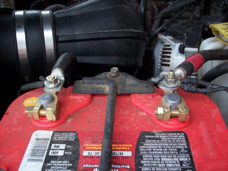

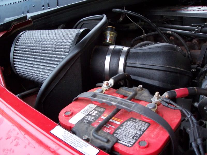

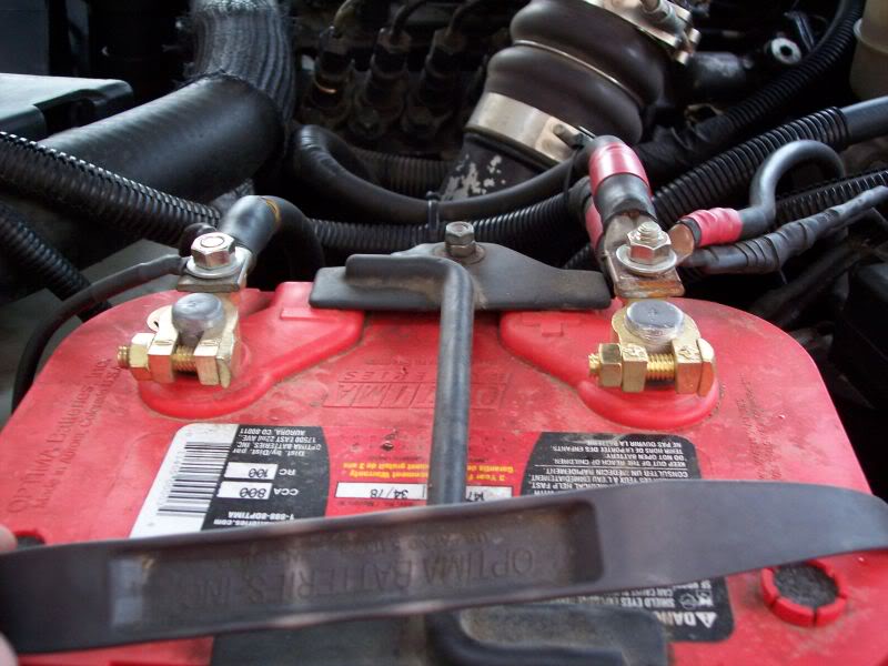

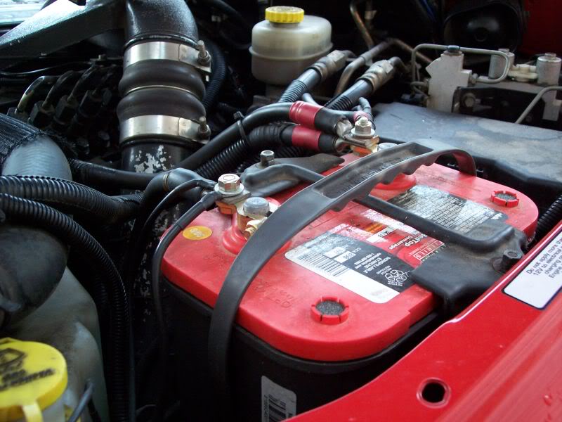

Yeah, I converted to group 31's a few years ago. Be careful what kind of batteries you buy. I bought Deka batteries - they sucked and didnt last long. I have since converted to group 34/78 Red Top Optimas and havent had a bit of trouble since.
I had to cut out one side of my battery trays. Instead of lengthening a couple of cables, I just went ahead and replaced all of my cables with 2/0 welding cable. I used crimp on cable ends with military style style battery clamps.
A good place to get this stuff is Heavy Duty, Aftermarket, Custom Battery Cables for your Car, Truck or RV (including the length of cables youll need to make)
Is that kind of the info you were looking for ???
Heres a couple of pics of mine:

4/0 is VERY thick cable and really not needed unless maybe you are running it the length of the truck. 2/0 is even overkill.
If I was buying group 31's again - Id probably just get Interstate Workaholics or Workhorse. Make sure you get ones with SAE type terminals. Some group 31's have smaller stud type terminals.
I cant comment on those group 31's but like I said, the offbrand 31's I had were junk.
