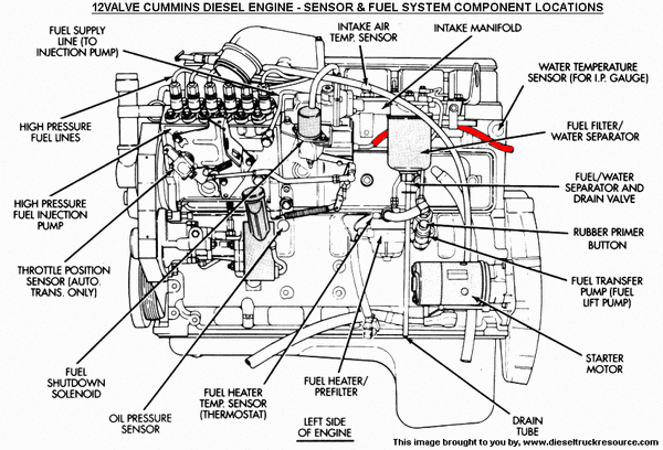

Most people simply eliminate the steel fuel lines and run hose all the way from the tank.
You are still having pressure issues. Replace all flexible lines that you can. Feed is 3/8" and return is 5/16". Make sure you get the little 4" long return line - the red one in this pic:
Try to get diesel rated fuel line - the best stuff is marine rated. If you use regular fuel line, you may be doing this job in the not so distant future - and its not a fun job (as Im sure you already know).
If that doesnt help your fuel pressure (yes its still a tad low), I would look at the overflow valve (on the outlet of the pump - at the front). Be careful not to loose the sealing washers if/when you remove the overflow valve. If youve never replaced this - pick one up.
