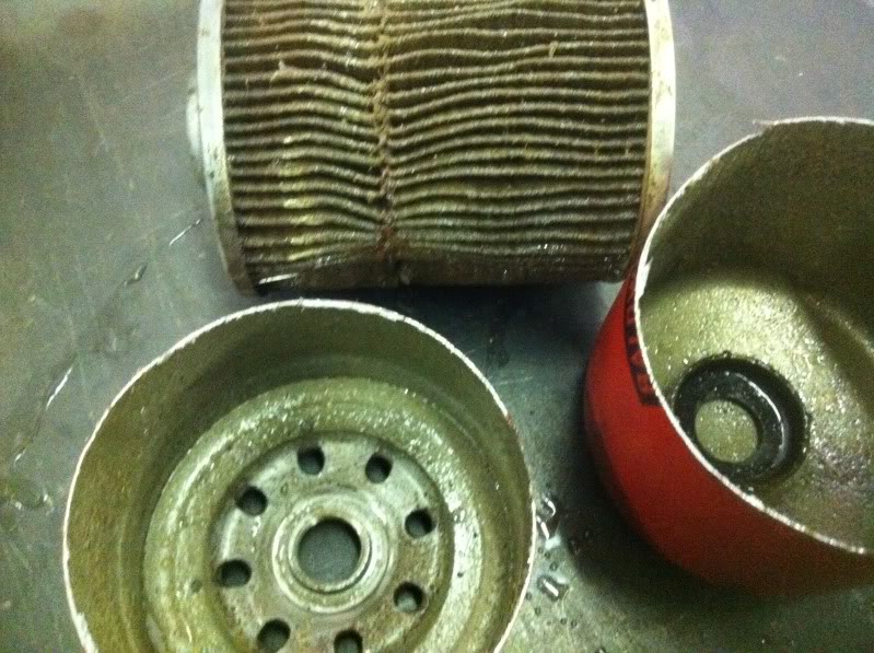

I bought the Diesel Site Coolant filter Kit
Installation was easy and straight forward
Yes i cut mine open after one year
Then i changed the filter again flushed the system with distilled water and used CAT 1 antifreeze

You went a year on the first one? Don't they say like 1000 miles for the first change? You can tell when they need changing just by feeling the aluminum filter head. If it's really hot, coolant is flowing through it, if it's just warm from heat under the hood and not really hot, nothing is flowing and it needs changing. I use the dieselsite setup too. They're the same thing, just pick which colors you like best.
Old Apr 23, 2012 | 08:56 AM
jimrd's Avatar
Posts: 190
From: Orillia,ontario
i went one year
if you grab a flash light and take the cap of the coolant over flow bottle you can see the coolant go back to the bottle
and the alum filter housing was hot...so i know there is flow
Based on the pics these filters work
thanks

They work very well guys!
I'm amazed you made it a year on that filter, nice! Must have been pretty clean inside. Had you done a flush or anything previous?
Old Apr 30, 2012 | 07:18 AM
jimrd's Avatar
Posts: 190
it must have been flushed prior to me owning the truck
