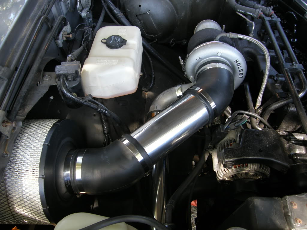

Here is what i did.
for the pipe i used a piece of aluminized exaust and polished it, here is where to get the boots.
AIR FLOW SYSTEMS INC.
then here is how to do it.
Basic Turbo Intake Tube Upgrade Guide - Dodge Diesel - Diesel Truck Resource Forums
Dar

whats the diameter and the length of that pipe and what did you use for your air filter to stay sturdy i spent like 80 bucks ona KNN filter and dont wanna try and buy any other to make it work
Old Jan 11, 2012 | 09:10 AM
ricet07's Avatar
Posts: 456
Likes: 28
From: Argyle,WI
You can use a piece of flat stock and bend a 90 on each end, with a hole drilled in one of the ends. Then stick one end under the band clamp on the filter and bolt the other side to your inner fender or wheel well.
