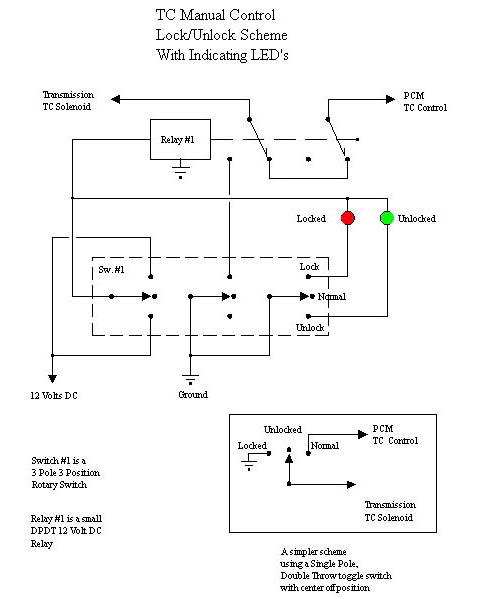

Yep, that's what you need right there. The relay isn't a bad idea either. I had help building mine, but it'll lock and unlock, and also has lights letting me know when I have it locked or unlocked. If you're interested, I can try to find the wiring diagram for it.
Now that I think about it, the relay might not be a good idea if you're planning on using the exhaust brake and the service brake at the same time.

If you could find it that would be great. I have the wiring diagram for my truck and traced it all and it seems correct to me. I saw on another post a guy put a 33 Ohm resister inline on the leg he grounds and says he doesn't have to jumper the relay. Not sure how that effects the TCM. It must see the resistance and energize the relay. Was going to try it first to avoid jumping the relay. Jumping it does heat up that curcuit all the time. The relay takes referance voltage from the alternator and has a control point in the TCM which is where it gets it's ground.
Anyway I would love to see your implimentation, I want lights or some logic that I can build off the cruse control speed detector cause I really think an automatic should be just that, automatic.

I got this from a guy on TDR. He's also the one that built it up for me.
This is what he came up with for me:
I painted it to match my interior.

Very cool man, what a clean job. Lock, Un-Lock, and Normal Op. I'll let you know how it goes.
