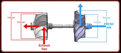

I have a question that might sound stupid but what the measurments all stand for? Are the first two MM and the last one CM? Was thinking about the compound set up but sounds and looks hard. Any thoughts?

The mm is the size of the inducer of the compressor wheel the second is the size of the exducer of the turbine wheel. The cm3 is the volume of the turbine housing, they use cm (cubed) and a/r ratio.
