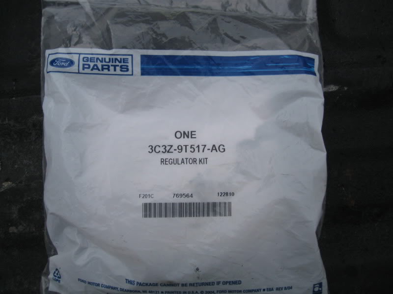

Yeah there is a rubber "o"ring of sorts in there. While you're pulling it apart, put the updated fuel regulator spring in there. Just order the whole kit, it will come with that cast cover, the o-ring, the new spring and pretty much everything plus some to do the job. It's around $75, or if you can find someone who can get it at cost, it's a little cheaper.
Here's the PN you need...
Try emailing this guy: Jim Cockerham [jim@sunriseford.com]
They offer 25% off to members of powerstrokearmy.com Just shoot him an email and tell him you need a price on that part number.

3C3Z-9T517-AG is the revised fuel pressure regulator and ups the pressure its a good kit to do along with 6.4 banjo bolts
W302472-Youll need 2 of these, theyre the banjo bolts
W303659-Youll need 4 of these, theyre the washers
