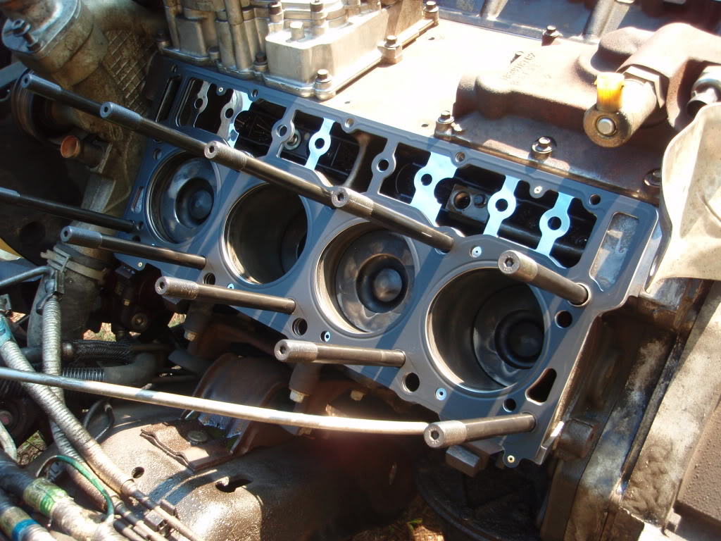

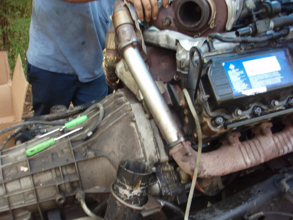

Ok, started on Friday and it is now the end of the day Saturday. We have the cab off, and the heads are removed. Took us a full day to get the cab off under the circumstances haha. We had to rig up a few things but it all worked out. Here are some pictures and we are hoping to be done by Monday night! Keep your fingers crossed

We got the heads off no thanks to that braided oil line that goes down into the block. I guess you need a specialty tool to take it off but we just made our own. Ill get those pics up tomorrow. Everything has gone pretty smooth so far except that. If any of you guys plan on doing this or have any questions let me know. Goodnight for now got to hit it hard again tomorrow.

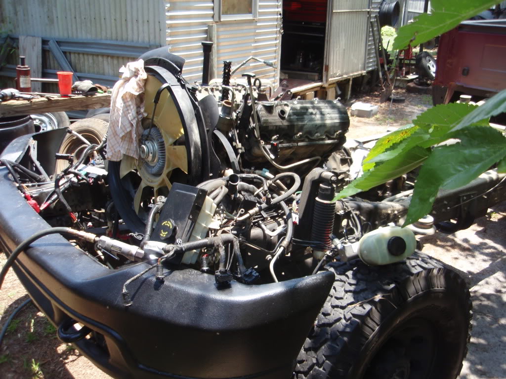

Well boys i got the head studs, egr delete, and everything from the block up back on the engine. Also got the cab back on and the interior put back together, Cleaned the radiator and the inter-cooler out. The inter-cooler was filled with oil. I spoke with someone who told me about a really cheap turbo mod because the VGT drains oil into the intercooler???? Said he has a hose running from the turbo to his frame rail and thats where is excess oil goes? Anyone heard of this? Said it was the CNV or C something mod. I found out that the turbo has been remanned. Doesn't have a date or mileage on it. The fins in the turbo dont have any play and look new. Is it normal for oil to be in the cooler??

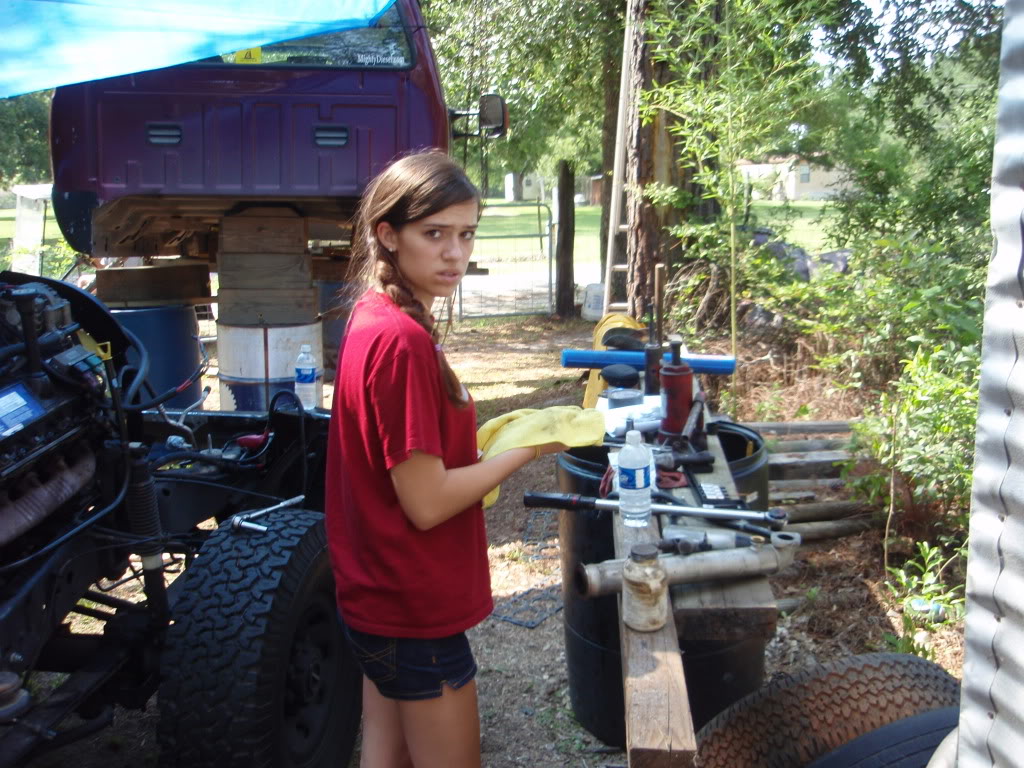

Got the wife out there today to help clean up and sort tools that were EVERYWHERE. As you can tell she wasn't too enthused haha. I also put up some pictures of the socket i had to cut to be able to get that braided oil line out of there. I still say that was the hardest part of breaking that engine down.
