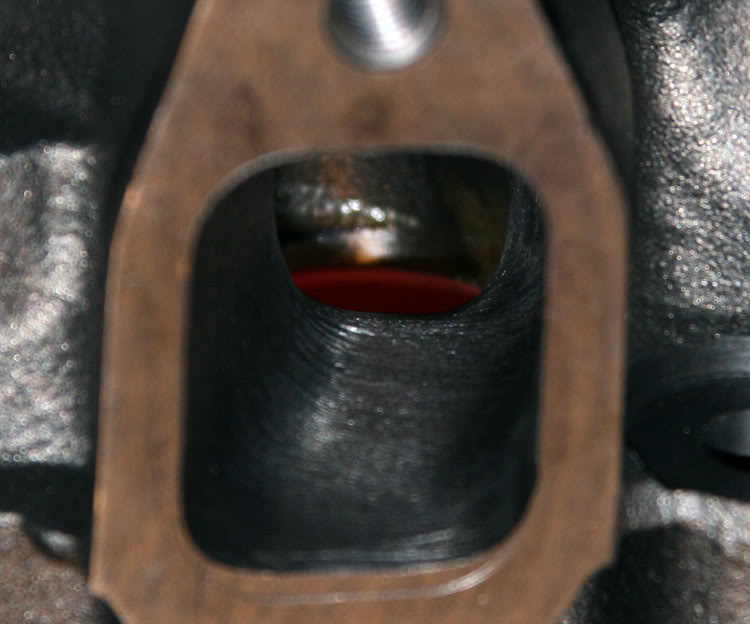

I strongly urge one to shop around for a head-guy that's familiar with the 12v. Must have a flow bench to ensure actual gains and uniformity across all six cylinders.
- If you're not gonna cut off the intake manifold (requiring an after-market bolt-on intake log ~ $$), then you're pretty-much stuck with cleaning up the intake bowls.
- You can get to all the exhaust ports.
Remember: flow of as much volume as possible is the goal, uniformly, not just hogged out 'n polished pipes.
Intake bowl . . .

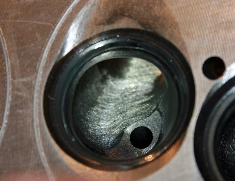

Exhaust bowl . . . .

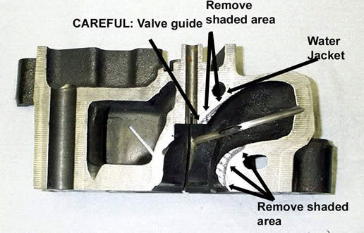

Exhaust port (floor)
