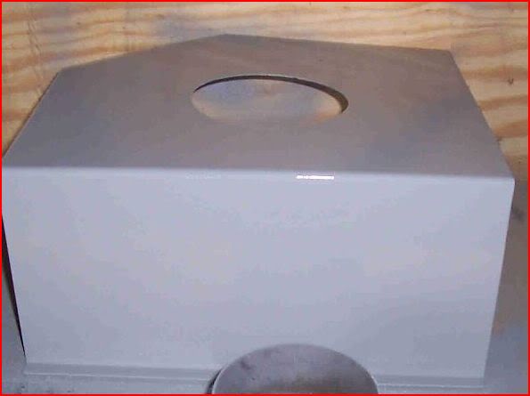

I run a really big filter I have plans for a ram air system in the spring..
The hood in the works..
