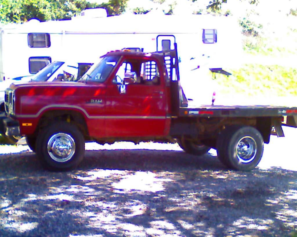

That's what I paid for mine .
Sorry about Hijacking.
