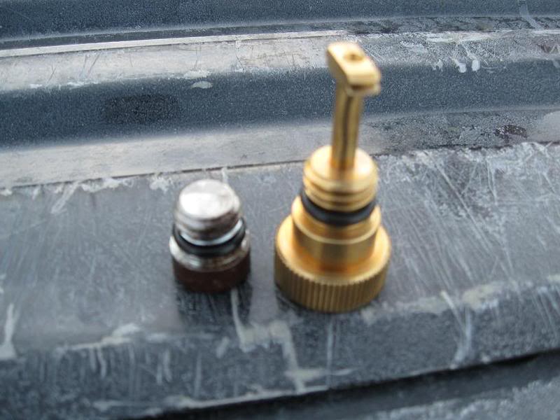

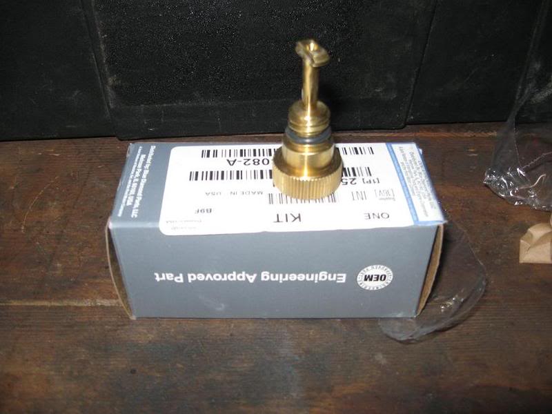

Here's a pic of the brass plug...
You can see it comes with a new rubber o-ring as well.

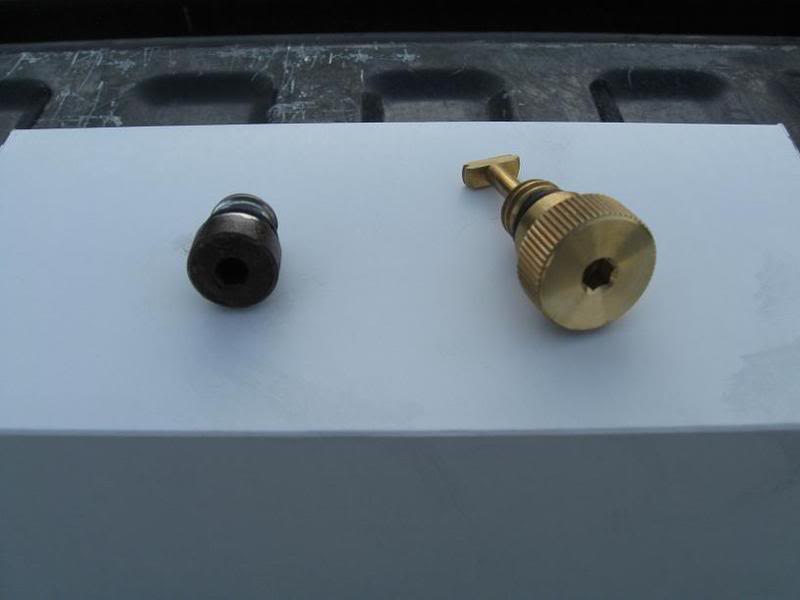

Here's a comparison to the factory cast plug...

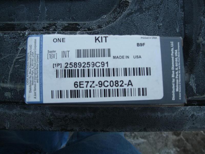

Here's the P/N for the brass plug!
Enjoy!

how much is the brass plug?
Old Dec 24, 2010 | 01:02 AM
Mdub707's Avatar
Posts: 8,208
Likes: 630
About $15.
