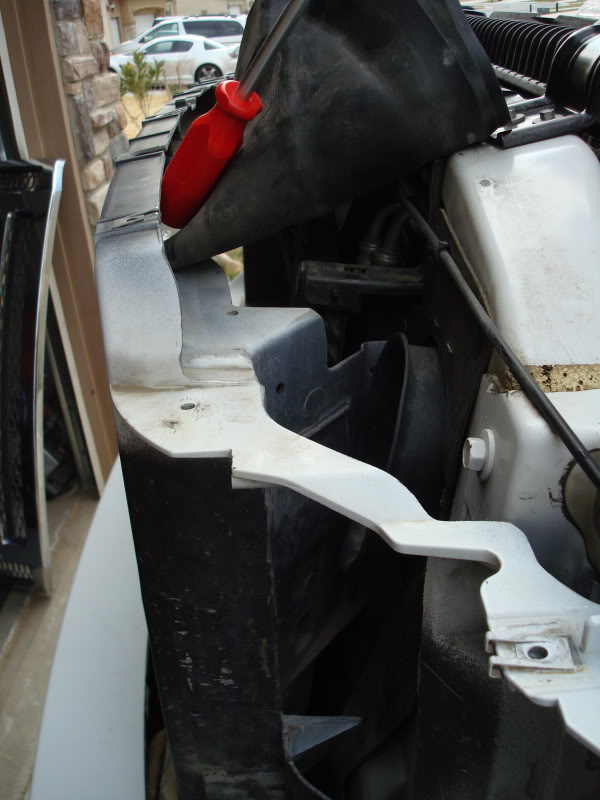

This is the cut you need to make in the plastic
And pull out the metal bracket that goes in here

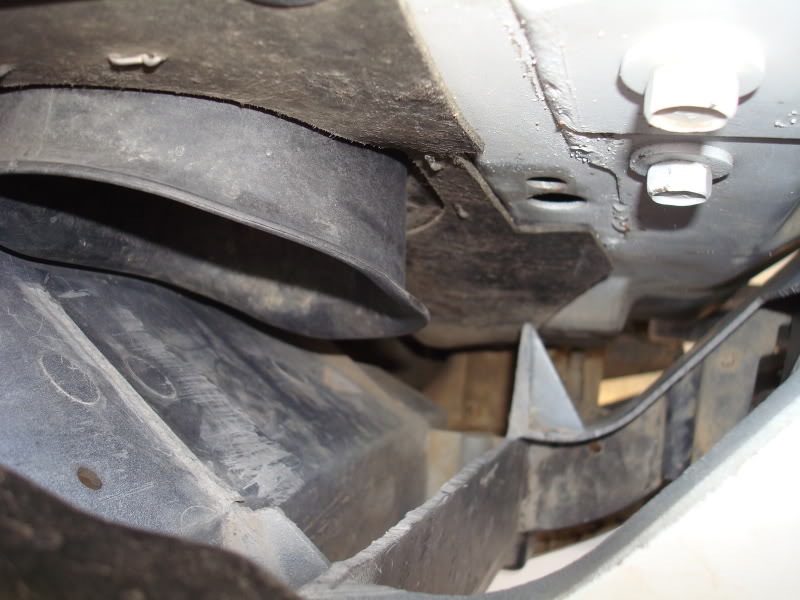

Yes this is the easiest way I found to keep the plastic mat out of the way

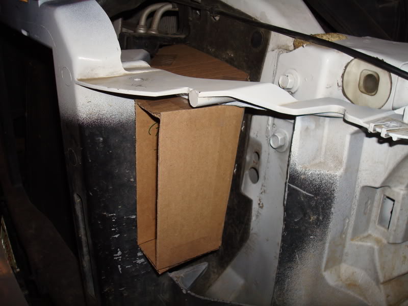

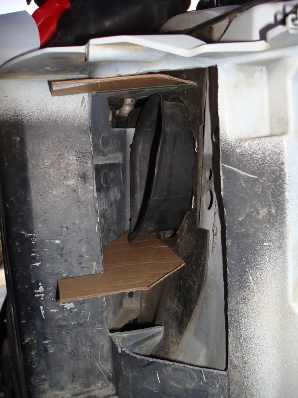

Test fit of the top and bottom pieces

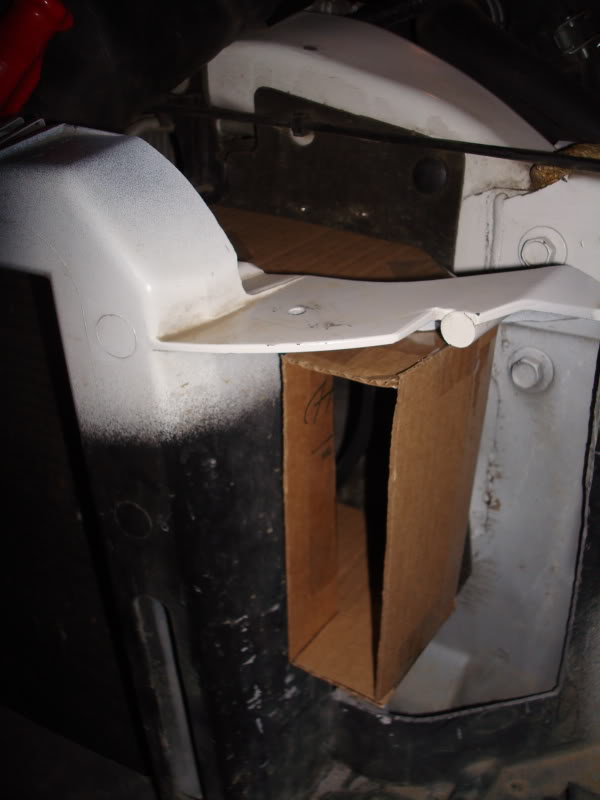

This is the scoop (I would love to give you guys measurements for the cardboard but there are so many angles and different lengths, the scoop is 6" tall though)
Now time for me to get some sheet metal and fire up the torch
Yes, it's a big cut in the panel, but if you make one of these scoops you will understand it, I just cut mine a little too tall though.
