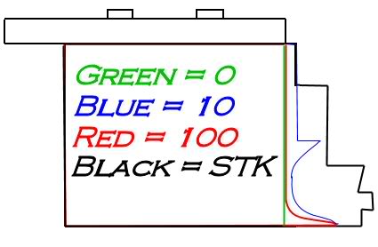

then i guess it was owned by some 16yo that liked to dump smoke, i bet tuning the AFC back would fix your problem..
you might aswell get a #10 plate while you're at it and have it slid 3/4th back...
does it feel like the transmission is slipping ?

whatd do you mean turn the afc back?
Old Sep 9, 2010 | 09:18 PM
94 12valve's Avatar
Posts: 3,504
Likes: 157
From: Pylesville, Maryland
slide the housing back and crank the starwheel maybe even the pre boost screw back if it was changed
