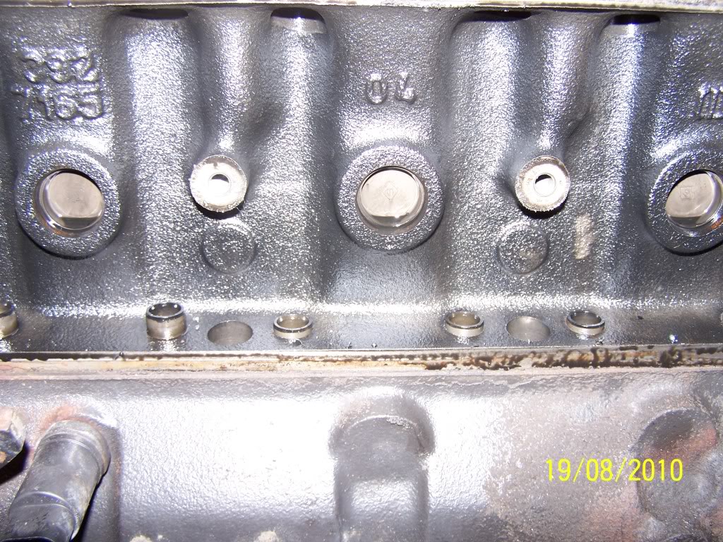

This is a hard part you have to hold up the tap-its I used a pare of plyers and pulled each one while putting psi on the cam
Rotate and remove the cam tap-it by tap-it and set on floor (standing up an tie to something so it wont fall over)
