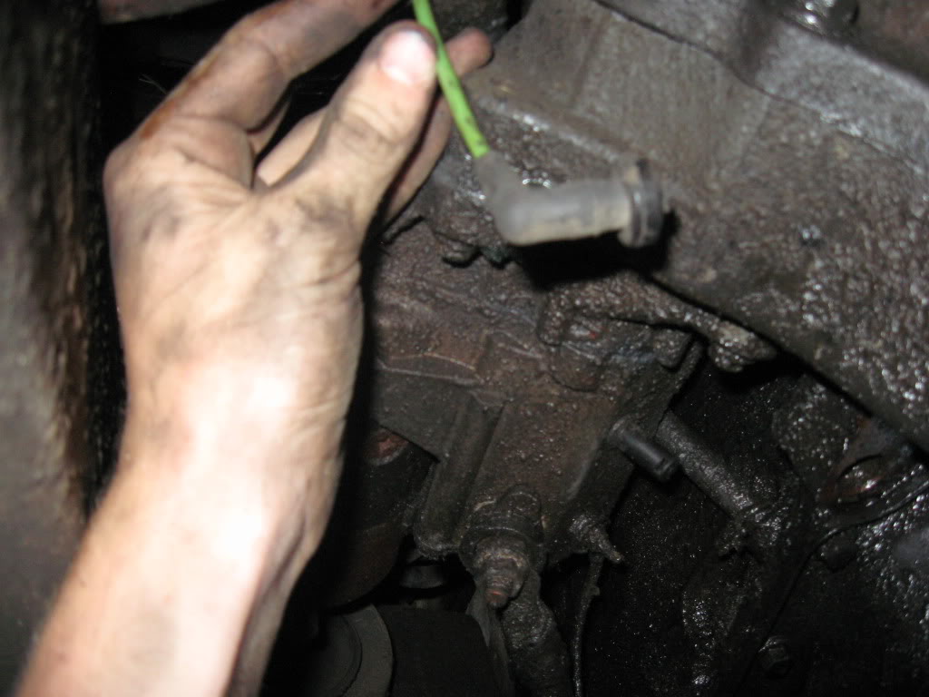

i had to replace my clutch and the vacume lines from the engine got unpluged and i can't figure out where they go i think they are black and green lines and pics would be awsome if you can get a camera where the are pretty sure the go on driver side

could you post pics of the lines you are talking about?
The only lines I can think of are the T case vac lines used to lock the front axel ... othere than that should be a t case breather and a trans breather tube.

i'll try and get some pics later but it is the lines that go to the engine because the front axel has to get vacume from somewhere

Don't they go from engine to TC then from there to front dif

yes there is 4 lines one is a suction line from the vacuum pump one is a enguage line for the CAD 1 is a disenguage line and the other is just a relief line

is this the relief line and does it just not plug into anything

yes that is the relief line

k and that doesn't get pluged into anything i found where the other line plugs into thank for the help
