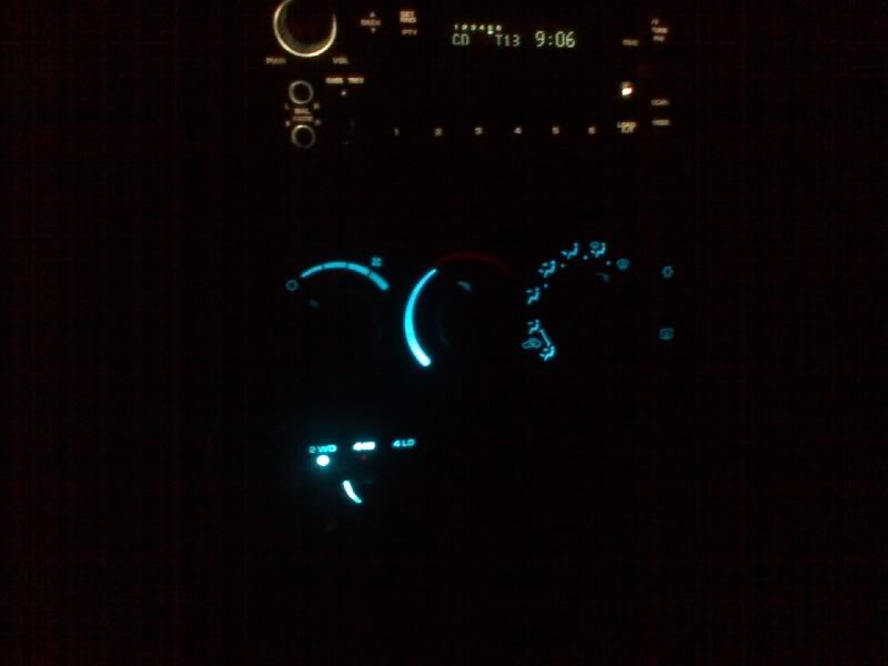

yes they most certainly do.
If you are industrious you can do the light switch and 4x4 switch (if you have the shift-on-the-fly T-case)

Thanks man! so all you did was change out the bulds with blue leds?
Old Jun 18, 2010 | 12:49 PM
ShibbyUTman's Avatar
Posts: 7
Yessir, for the ones in the cluster infront of you I'd recommend going with the High Output LED's, my buddy did the same with the low output ones and they are a little too dim for me. To each his own i guess, but yeah, it takes 11 bulbs total to redo the cluster so it gets kinda spendy but it isn't something everybody is going to have. (if/when you go to do it most LED's are polarized, so if you turn the lights on and it doesn't work, then pull it out and flip it around)
