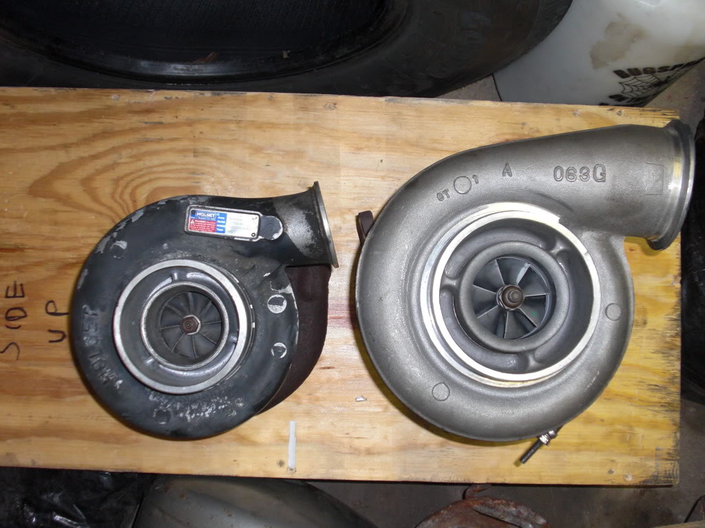

Originally Posted by IH1206
Hey guys, can anyone tell me what kind of turbo and what size (a pic would be great) came on 1994 12v's? and anyone got an idea of what size intercooler(dimensions, air flow #'s)?? thanks, and im new here!
here are some pics
wh1c on the left s465 on the right
