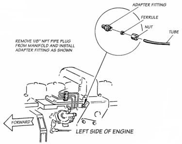

Originally Posted by 94cummins12v
first you dont weld a port on your exhaust you drill and tap it were the 6 banks come together. secound you dont drill and tap anything on your intake to mount the boost guage there is already a 1/8"NPT plug in the side of the manifold between the #2 and #3 cylander, third its harder to drill post turbo because the cowl is in the way for of the drill which its better to do pre turbo anyway. separated the turbo 1" away from the exhast maniflod, put a rag between the two, drill/tap, start wngine with rag in there only for a few secounds withought igniting the rag then put it back together
Pyrometer:
Boost Guage:
You can also drill and tap the intake horn but why bother?
Old May 21, 2009 | 10:25 AM
94cummins12v's Avatar
Posts: 4,525
Likes: 103
From: Havre mt
thanks evil i was looking for pics last night of it and didnt seem to come up with any. FYI do not drill in the center of the exhasut manifold, you have to either go slightly back or forward becasue there is a rib in the center. i drilled threw it and had to drill another hole
