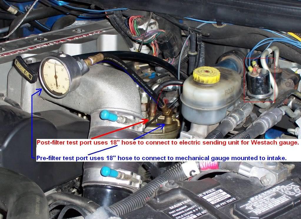

Old Feb 16, 2009 | 07:02 PM
Originally Posted by BigManBrad
Well i want to know where i should hook the sender unit up at.
Well, I can answer that for you Brad....you can hook your sender up to the front port of your fuel filter canister, as seen in this pic (I would personally go this route):
heres another version of it:
Or, you could use the test port on the VP-44, as seen here:
If I were you, id go out and get myself a mechanical fuel pressure test guage and anytime the electric guage hiccups, check the fuel pressure with a mechanical guage. OR, trash your electric and install a mechanical guage.
