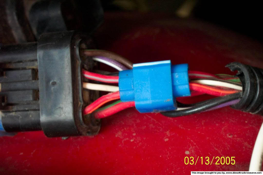

I have had the same problem with the DTRL...the only thing is that now that i have unpluged the wire from the moduel the bright lights will not come on now....the regular lights will come on when turned on but the brights..... Any sugestions......

Yes, Im pretty sure lil dog has the answer for this. I believe its as simple as a jumper wire. If he doenst answer this - I will PM him.
Found this:
So its looks to be just as simple as a jumper - this is on a 97.

Aight heres what i found out...i did unplug the module and come to find out when you unplug it, the bright light sign on the inside of your truck dash doesnt come on or show that they are on but they really are so
