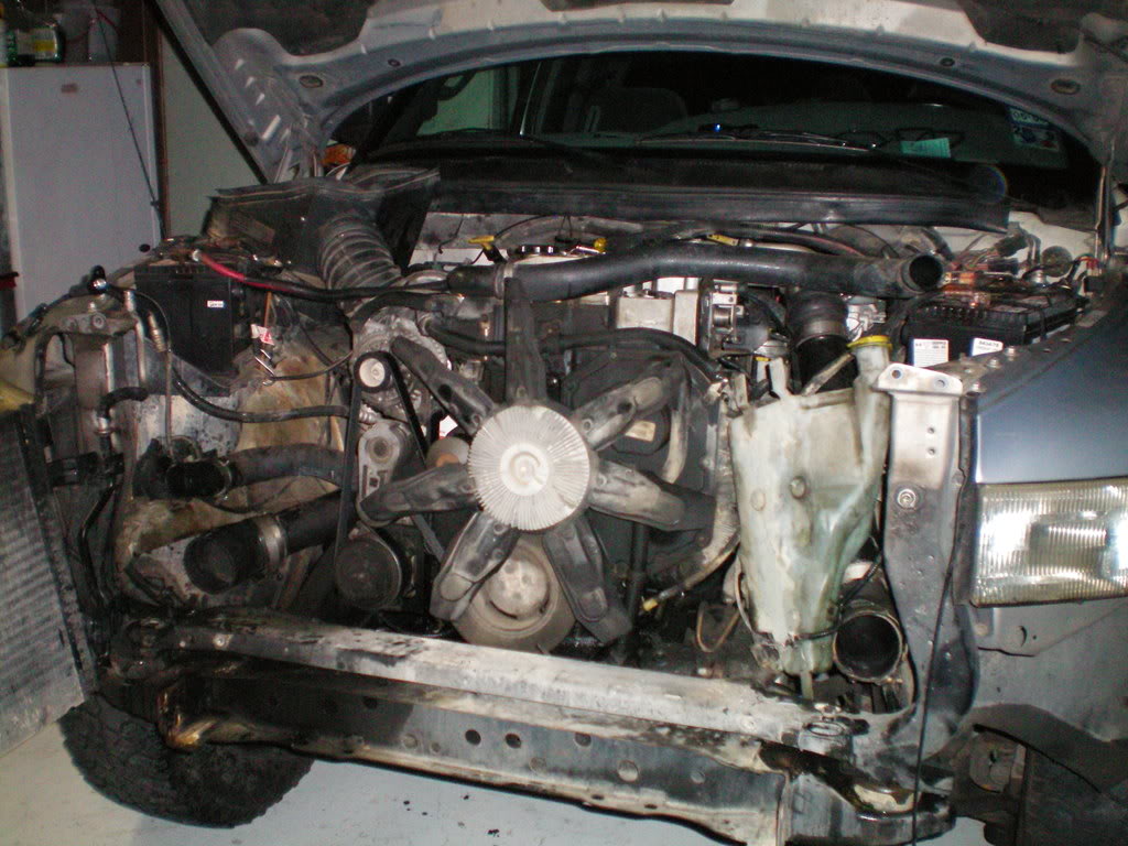

What els is a good idea to change or play around with while i got this done? I really dont want to see this again.
Any tips would be nice.

Bout the only real issues up front are the KDP and all the other bolts under the timing case coming lose, so be sure to check all of em. New seal around the fan opeing in the cover. A good cleaning of the radiator and do any mods on the puke bottle you ever want to do. Guess it would also be a good time to pressure test the inner cooler to check for leaks.
Can't think of much more on the front there.

Check the cam retainer for wear and replace if needed. Might as well swap the cam as well.
Dave
