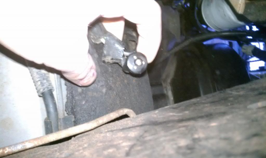

Well guys thanks but it may have gelled up but it was in the 30s. I did get it running though i changed fuel filter and prefilter and cleaned it up the o rings were disenagrated. And i also changed the fuel return rubber hose. With all said and done started right up and drove it 300 miles and was 26 degrees and still started right up. But just wondering guys about these. Pics below first one is what the plug for right on top of the 10mm fuel filter bleed screw. And next whats the vent looking deal for the vacuum lines is it suppose to be plugged in some where. Thanks alot.

Tht line is part of ur vaccum brake system looks like
