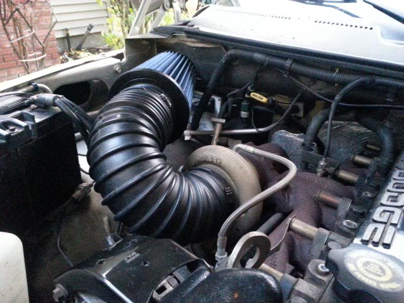

Here is my setup... I am using an Amsoil Nano filter...
