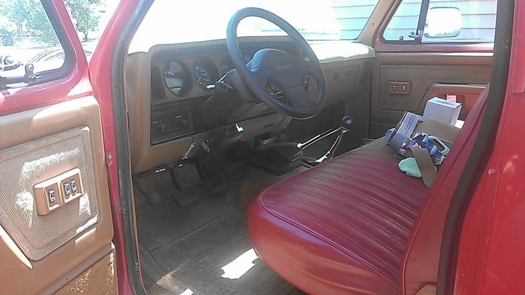

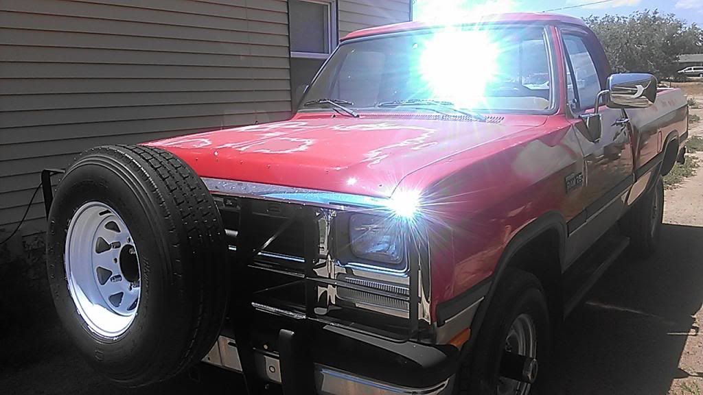

So I did it I bought one! Ive been reading on here for several weeks now, working my way up to buying a gen 1 cummins. I bought the truck from my old man took some convincing and prolly more money then its worth about 9 grand ....He bought the truck about 15 years ago and has never used it...he bought two of them meant to be work trucks for the farm. The one I bought was the backup. He never did anything with it as about 10 years ago he had a stroke that affected and disabled the right side of his body, but the lord permitting he is still with us The Awesome thing about this truck is it only has 101,433 original miles on it....the interior is pristine and been shadded from the sun!!! The body is straight as an arrow rust free the frame is still painted black.....the only thing wrong is the clear coat is pretty bad from just sitting in the sun at the farm....and everything is still very dusty.... It also has an exhaust break....which isnt very common on this motors from my understanding.....which makes me worry abit cause ive heard without heavy duty valve springs you can float them pretty easy?.... pics coming quick!

I don't think you paid too much for it. Nice truck, well equipped and low miles. Great find I'd say.

That looks like a BD diesel exhaust brake. I love mine, but the springs may be an issue. I know when I got my gov spring; I was told be a reputable shop that upgrading the valve springs was not necessary. It may be the same for the exhaust brake. Get a gov spring for $20, do the free pump mods and it will run much better. I upgraded my turbo too. The H1c is good for 20psi, or at least that's all mine would do. I saw 45psi out of the hx40 I upgraded to.
You got a good deal IMO and it looks like a decent truck. The only other thing I upgraded was the brakes to a hydroboost system. It makes a world of difference if you tow.
