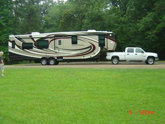

Question Upgrades for towing?
On my 2004.5 LLY crew cab 4x4, looking to upgrade some stuff to help with towing our 5ht wheel camper. Plus will be doing something to help with the heating up issue. It does not over heat, but does get warm enough for the fan to run way to much. But then again temps been 100+ and towing 15,000 lb of camper.
If this was your truck, and you were looking to help it out on both towing and temps. What would you do to it?
Its stock other then 19.5 wheels and tires and right at 110,000 miles on it.

Dang!!! Nice trailer. A tuner for towing will make a world of difference. There are several to choose from. Research them first and compare before you purchase. Dont fall for gimicks.
