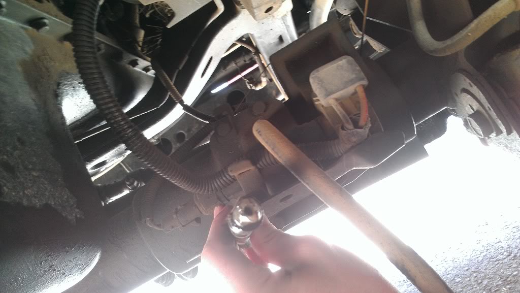

So my first question is in regards to this hose. This hose was leaking out of no where yesterday, probably leaked about 1/4 cup onto the ground, and it's definitely gear oil, not ATF. I parked it in the same position that I usually do, so im confused as to why it would have leaked. I'm pretty sure this hose should connect to something...
It looks like a differential overfill to me, but I have never seen or heard of that before
second pic provides a better over all picture of where the hose starts

The first is a vent hose for front axle. Look at the rear axle find the same thing

Second tube is the blow by tube for the motor
